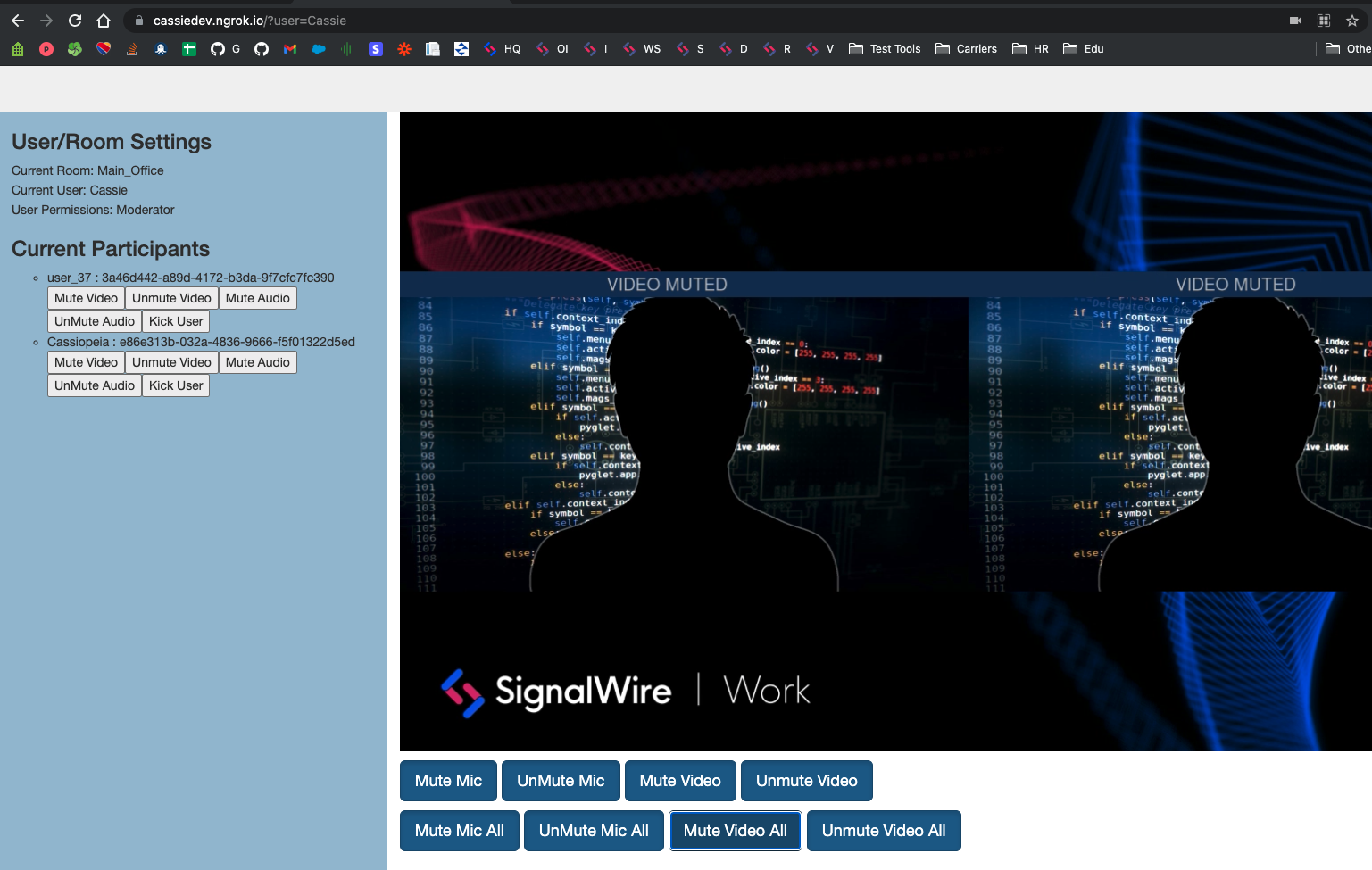

Below is a screenshot of the moderator view. Notice the controls on the left and at the bottom of the screen:

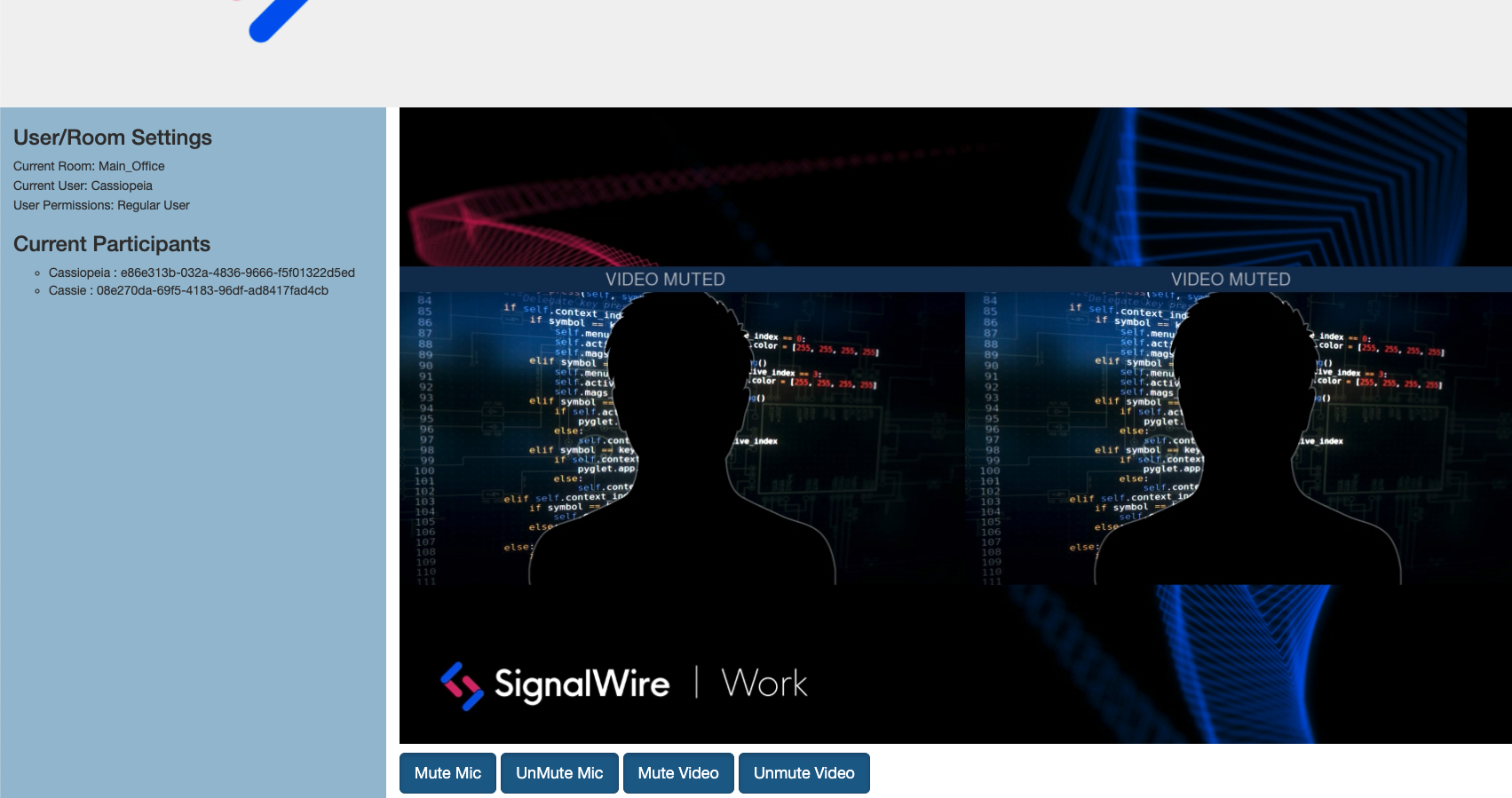

Below is a screenshot of the guest view:

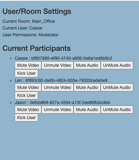

When you are in a room, it is helpful to be able to see all of the users who are in the room with you. The function listParticipants() will list all the current users and if you're a moderator, it will allow you to control them with buttons. listParticipants() will be called any time the room is joined and any time a member joins/leaves so that it is always updated.
Below is an abridged version with the main points. Here we will go through the participants one by one and list them as an HTML element. In the nav bar (or wherever you'd like participants to be displayed), we need to create a <li> element with an id equal to "app". In listParticipants(), we will start by creating a ul element called list and selecting the <li> element with id app set to the variable app. We will set app.textContent to an empty string to make sure that every time it is called, the original list is cleared.
We will loop through our array of participant objects and create a <li> element with text content equal to a string like "UserName : User ID" for each user. We will also add buttons for each moderator function (only videoMute shown below). We can make the button functional by setting the .onclick event equal to the function we defined earlier, videoMuteMember(id) with the participants userID as the id argument. This same process can be repeated for all the other buttons. We then append to list the li element with username and user ID and the buttons to mute/unmute that user, in that order. Lastly, outside of the forEach loop we will append list to app, which will make it appear on our nav bar.
function listParticipants() {
  var list = document.createElement("ul");
  var app = document.querySelector("#app");
  app.textContent = "";
  participantList.forEach(function (elem) {
    let sid = Object.keys(elem)[0];
    var userId = elem[sid].userId;
    var li = document.createElement("li");
    li.textContent = elem[sid].userName + " : " + elem[sid].userId;
    var videoMuteBtn = document.createElement("BUTTON");
    videoMuteBtn.innerText = "Mute Video";
    videoMuteBtn.onclick = () => {
      videoMuteMember(userId);
    list.appendChild(li);
    list.appendChild(videoMuteBtn);
  app.appendChild(list);
