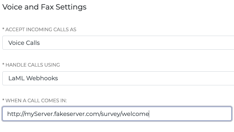

You can use this application as both an inbound or outbound survey. To use this script as an inbound survey, expose it to the web (through a server or SSH tunnel) and use it as a webhook for handling incoming calls under phone number settings. For this script, you would use the server url and the /survey/welcome route, like this http://myServer.fakeserver.com/survey/welcome.
You may need to use an SSH tunnel for testing this code if running on your local machine. – we recommend ngrok. You can learn more about how to use ngrok here.
