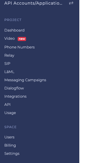

You will need a SignalWire phone number as well as your API Credentials (API Token, Space URL, and Project ID) which can all be found in an easily copyable format within the API tab of your SignalWire portal.

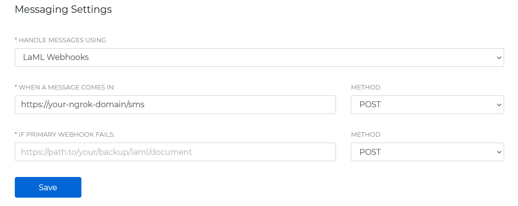

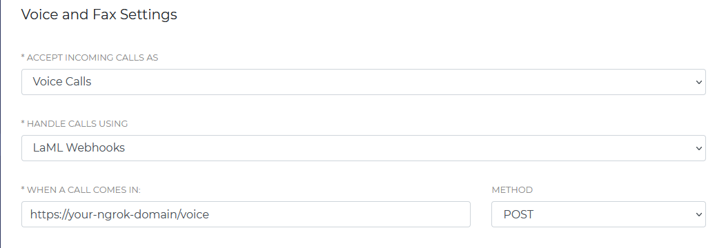

You can then set up your SignalWire DID to point at your-ngrok-domain/voice
for voice calls and your-ngrok-domain/sms
for messaging.
