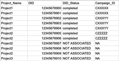

Output

Want to find out which of your numbers have not yet been associated to a campaign? No problem.
Alter the code above by adding the snippet that is referenced below at line 207. This snippet will list out all numbers that are present in your project via API and compare them to the numbers that are already present in your data table as having a campaign assignment.
this_proj_nums=[]
for p in number_of_10DLC_projects:
    space = space
    API_Token = proj_auth_df['API_Token'][p]
    Project_ID = proj_auth_df['Project_ID'][p]
    # We declare our client so we can use functions from the python SDK
    client = signalwire_client(Project_ID, API_Token, signalwire_space_url=space)
    # Find Name of the given project
    Project_ID_API = client.api.accounts(Project_ID).fetch()
    # List all Numbers in accounts that have a campaign associated
    incoming_phone_numbers = client.incoming_phone_numbers.list()
    for record in incoming_phone_numbers:
        this_proj_nums.append(record.phone_number)
# Determine if number is already listed in our dataframe, and if not, append our unregistered_numbers array
# Find length of unregistered_numbers and append the remainder of columns in our dataframe
    number_nums_in_proj= len(this_proj_nums)
    if number_nums_in_proj > 0:
        for x in this_proj_nums:
                exist_count = DID_list.count(x)
                if exist_count > 0:
                    print(x + 'is already associated with a campaign')
                else:
                    print(x + 'is not associated with a campaign')
                    DID_list.append(x)
                    proj_name.append((Project_ID_API.friendly_name))
                    DID_status_list.append('NOT ASSOCIATED')
                    campaign_ID_list.append('NA')
    this_proj_nums = []

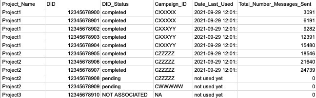

Add Messaging Activity to our Data Table
This last feature to our snippet will use the List All Messages API to search through each number and find when it was last used and also how many messages were sent from it.
This API requires the proper project ID and API token to be included for a given number, so we will be embedding this code into our loop of all projects. This is represented as for p in number_of_10DLC_projects:
To run this snippet, copy the below snippet and paste it into the above code at line 205. Make sure that you delete all of the code below line 205 before pasting in the below code.
# This is the part of the code that you must enter if you would like to incorporate information on messaging activity.
# The below code will create columns for the last time the number was used, as well as the total number of messages sent
# Lets pull up some data on the messaging activity of these numbers
# We will use our DID_List to list the date of each message sent from a given number
# Total Number of Messages Sent
    message_date=[]
    for i in Project_DID_list:
        message=client.messages.list( from_=i)
        for record in message:
            message_date.append((record.date_sent))
        # Append the Num_Mess_Sent array with the number of messages sent by the number being analyzed
        Number_of_messages_this_number_sent = (len(message_date))
        Num_Mess_Sent.append(Number_of_messages_this_number_sent)
        # Append our dataframe with the time of the most recent message sent. If no messages have been sent then add a note saying 'not used yet'
        if Number_of_messages_this_number_sent == 0:
            DID_last_used.append('not used yet')
        else:
            DID_last_used.append((message_date[0]))
        print('New row added for number  ' + i)
# We are so close to being done! All that is left is to turn all of these arrays into one large DataFrame named final_dataframe
final_dataframe= pd.DataFrame(({'Project_Name':proj_name, 'DID': DID_list, 'DID_Status': DID_status_list,
                                'Campaign_ID': campaign_ID_list, 'Date_Last_Used': DID_last_used,
                                'Total_Number_Messages_Sent':Num_Mess_Sent }))
# Display all rows and columns of the final_dataframe
pd.set_option('display.max_rows', None)
pd.set_option('display.max_columns', None)
# Lets print out our dataframe and see what this all looks like!
print(final_dataframe)
final_dataframe.to_csv('ALL_Number_Assignments_and_Messaging_Info.csv', index=False, encoding='utf-8')
