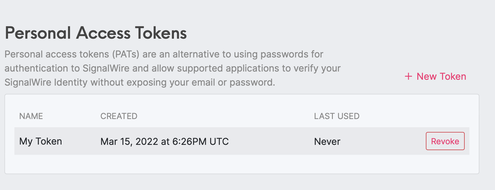

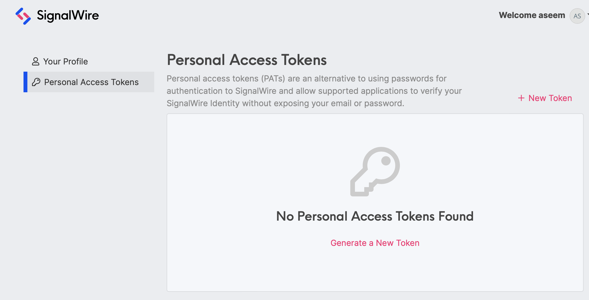

Getting an Access Token
A SignalWire account is now required to download the pre-build FreeSWITCH binaries. First create a SignalWire space, then go to your profile section and create a Personal Access Token. Click here to learn more.
