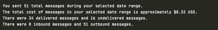

Lastly, we will use the data and values that we've calculated to display the total cost as well as some summaries about delivery status and the message type distribution.
print("You sent " + str(totalMess) + " total messages during your selected date range.")
print("The total cost of messages in your selected date range is approximately " + formattedCost + " USD.")
print("There were " + str(total_delivered) + " delivered messages and " + str(total_undelivered) + " undelivered messages.")
print("There were " + str(num_inbound_messages) + " inbound messages and " + str(num_outbound_messages) + " outbound messages.")

console.log("You sent " + totalMessages + " total messages during your selected date range.");
console.log("The total cost of messages in your selected date range is approximately " + totalCost + " USD.");
console.log("There were " + total_delivered + " delivered messages and " + total_undelivered + " undelivered messages.");
console.log("There were " + num_inbound_messages + " inbound messages and " + num_outbound_messages + " outbound messages.");

Now that we have the values for undelivered
, delivered
, sent
, received
we would print it out to the console for display
String totalMessage = String.format("You sent %d total messages on your space", messages.size());
String priceSummary = String.format("The total cost of messages in your selected date range is approximately %,.2f USD", price);
String messageStatus = String.format("There were %d delivered messages and %d undelivered messages.", delivered, undelivered);
String messageRecipent = String.format("There were %d inbound messages and %d outbound messages.", received, sent);
System.out.println(totalMessage);
System.out.println(priceSummary);
System.out.println(messageStatus);
System.out.println(messageRecipent);
