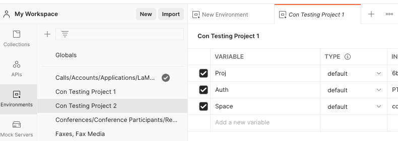

From within Postman, select Environments on the left-hand sidebar. Environments allow you to create some set variables that can be used throughout all your requests without having to put the values directly in the request. This saves a LOT of time!
What can go inside of environments?
This example will show how to use the environment to handle authentication variables (API Token, Space URL, and Project ID), but you could also use this to create a variable for your From numbers, To numbers, caller IDs, video room session IDs, and much much more!

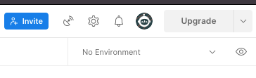

Click on the drop-down menu that says No Environment and choose the one you just created.

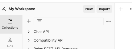

Setting up a Postman Collection

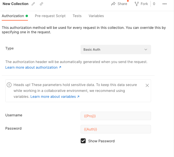

Next, we will create a collection to store your requests which will allow you to authenticate once at the collection level instead of at the request level every time. Click the New button to open a Create New submenu and select Collection.
Go to the Authorization tab and choose Basic Auth from the dropdown menu. For Basic Auth, you will enter your Project ID as the username and your Auth Token as the password.
Using Variable Names in Collection and Environments
In the Environment example above, Proj was used for Project ID, Auth was used for API Token, and Space was used for Space URL. You don't have to use this same naming HOWEVER you MUST have the same variable names in your environments as you do in the collection, or it will not authenticate the requests. Make sure your naming is consistent!

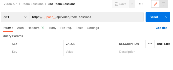

Use your environment variable names in between two sets of curly braces as shown below to access the values stored within them securely. If the variables turn red instead of orange, check to make sure you have selected an environment at the top.

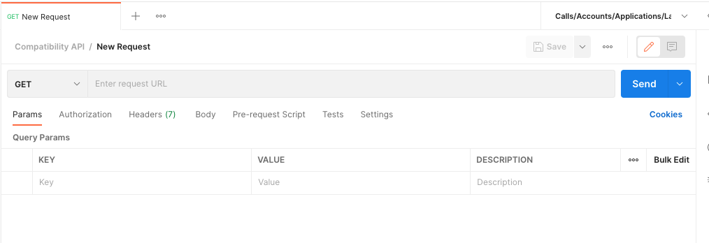

Hover over the collection on the left sidebar, and three dots appear. Click the three dots then click Add Request.
Now you can set up the request in accordance with the documentation in just a few seconds! Keep reading to the next section to see some real examples with our APIs.

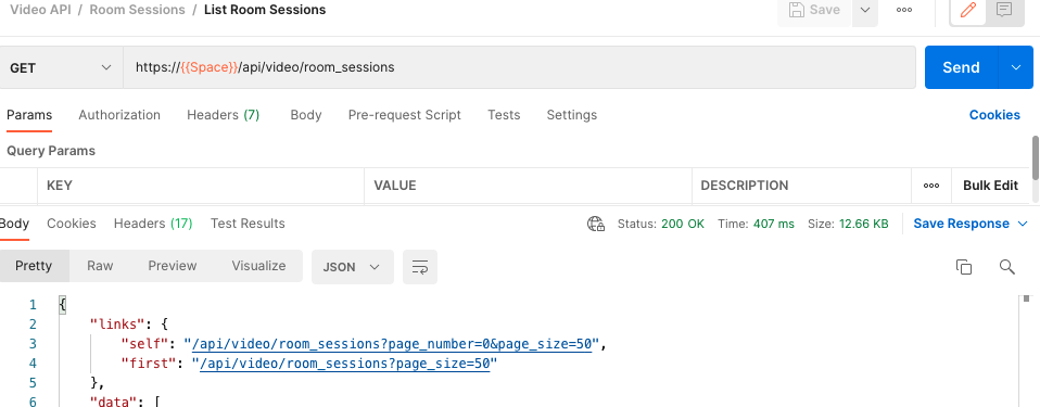

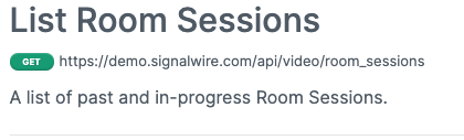

List Video Room Sessions
Take a look at the documentation for listing all room sessions from the Video API.
At the top, you can see that this request will use the GET method and has the URL https://demo.signalwire.com/api/video/room_sessions. Copy this URL and paste it directly into the request URL on Postman. Replace demo.signalwire.com with {{Space}} to invoke your environment variable, and press send!

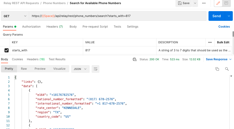

Search for and Buy a Phone Number
Postman makes searching for and purchasing numbers super simple! Copy the URL in the Number Search API along with any helpful parameters that you would like to use to help narrow down your search. In this example, we will use starts_with as the key and 817 as the value to only return numbers beginning with 817.

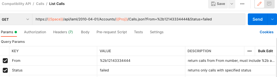

Pulling All Calls within a Date Range
Next, take a look at the documentation for Listing Calls. This component is very useful for getting reports on calls by date range, number pairs, status, and more. This example will show how you can filter all the failed calls from a particular number!
This is a GET request, so we don't have to change the HTTP method type. Copy the Request URL and paste it into Postman, but notice that this time there is an Account SID parameter in the URL as well! Replace demo.signalwire.com with {{Space}} and AccountSID with {{Proj}}. Now, we will add two Query Params key-value pairs: From and Status. Make sure to encode the number with %2b in front of the number, and don't forget the country code! Now press send, and view your call logs easily formatted for you!

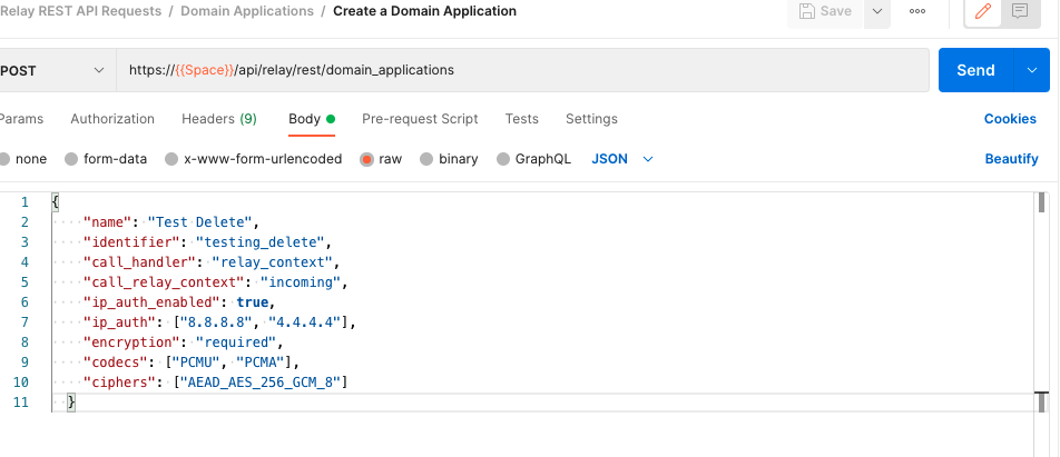

Create a Domain App
Our last example will show the other type of POST body parameters - raw JSON data. A good example of this is creating a domain application to handle inbound or outbound SIP traffic. Copy the request URL and make sure to replace demo.signalwire.com with {{Space}}. Switch to POST and select the body tab, but this time select Raw data with the type JSON .
Enter the parameters you want in JSON format and press send, and your domain app is created!

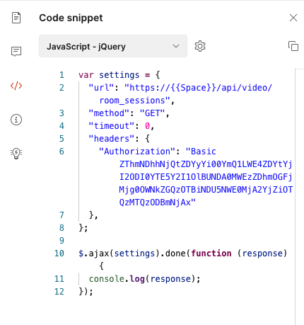

Generating Code in cURL or other languages
Once you have run a request successfully on Postman, you might want to save the cURL code for it or even replicate the same request in your application instead. Click the </> icon on the right next to Cookies to generate the curl code for your request or the same request in popular languages! This is the generated version of the request above in Javascript - jQuery.
