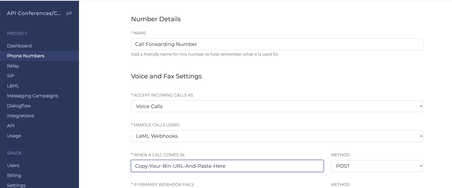

Click the Phone Numbers tab on your lefthand side nav within your SignalWire space, and click the specific number you would like to set up call forwarding on. If you don't have a number yet, now is the time to buy one!
Make sure that Accept Calls As is set to Voice Calls, Handle Calls Using is set to LaML Webhooks, and paste your Bin URL in as the value for When a Call Comes In. Click Save, and you're done! Inbound calls to this SignalWire DID will forward to the number you specified in the of the bin.

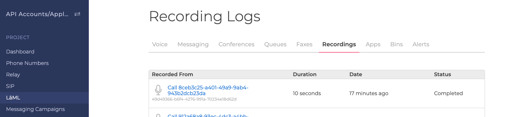

How to Access the Recordings
To access your recordings, click the LaML tab on the left-hand side nav. Click Recordings, and you will be able to view, listen, and download your recording files. You will also see the call ID and recording ID that you can use to access recordings via our API.
