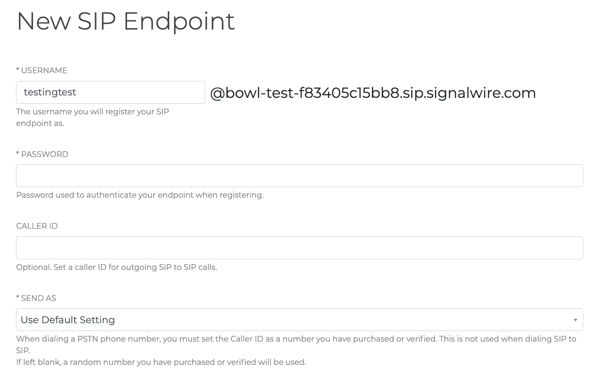

How to Set Caller ID Name for SIP to SIP Calls
To display a caller ID on SIP to SIP calls, you need to add an additional setting for caller ID in your SIP endpoint. Set the Caller ID field within SIP Endpoint settings to display caller ID on SIP to SIP calls. If you choose to set the Send As field, that will display one of your purchased or verified numbers, but it will only show for calls to PSTN numbers. Caller ID is the only way to display the caller ID for SIP to SIP calls.
If you want to set the caller names by extension for SIP to SIP calls, that setting is within the PBX that you're using. For example, Asterisk requires that you set the Outbound Caller ID name option on the dialplan. Check the documentation for your PBX of choice to learn how to send this parameter!
How to Set Caller ID for SIP to PSTN calls
Within your SIP endpoint settings, set the Send As field to one of the verified or purchased numbers in your SignalWire account. This number is what will show when you call a PSTN number. If you do not set anything, a random number from your account will be displayed.
