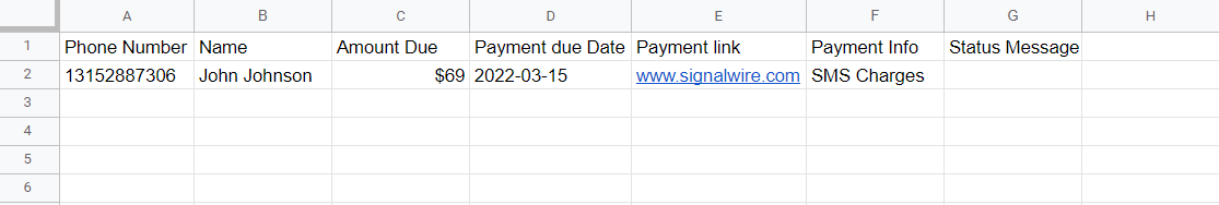

Create a Google Sheet
To begin, create a new Google Sheet. In the first row, create a column for each of the following:
  • Customer phone number
  • Customer name
  • Amount Due
  • Payment due date - must be formatted as yyyy-mm-dd such as 2022-03-15
  • Payment link
  • Payment info
  • Status of message - our script will update this cell after it runs
Next, fill in a complete row with your own personal information so we can test the script when it’s done. Do not include any dashes, spaces or parentheses in your customer’s phone number but you may enter it in any of these formats:
  • 2223334444
  • 12223334444
  • +12223334444
Once completed your spreadsheet should look similar to this.

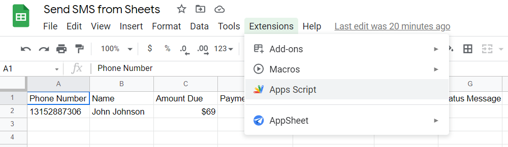

With our columns created, we now need to create variables in the code that will reference the information we input into these columns. To begin editing the code, go to the Extensions tab at the top of the page and select Apps Script.
Once you’re in the Apps Script editor, delete this placeholder code.
function myFunction() {}
After that has been deleted, you should be looking at a completely empty box of code. Now you can define the columns as variables by copying and pasting the following code.

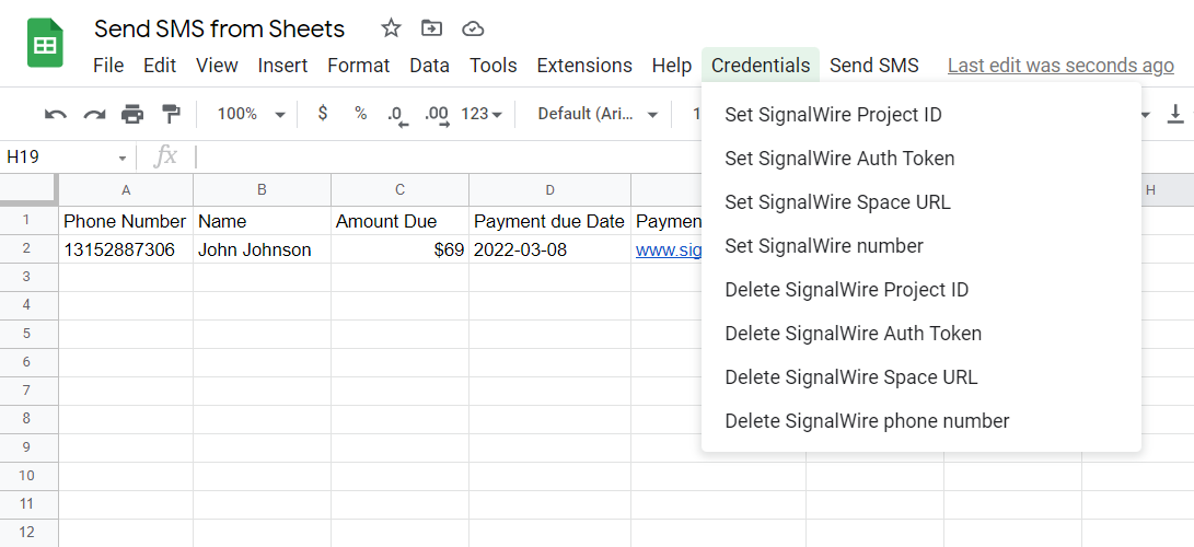

Create custom menus
The custom menus we’re creating will appear on Google Sheet’s menu bar along with File, Edit, View, etc.
The name of our custom menus will be Credentials and Send SMS. The Credentials menu will include a dropdown menu where you can enter/remove your SignalWire Project ID, Auth token and Space URL while the Send SMS menu will allow you to send SMS to all numbers on your sheet, or to send to only specific numbers that fall between a given date range.

Create the functions for our SignalWire credentials menu
With what we have so far, a custom menu titled Credentials will now show up on your Google Sheet, but it doesn’t currently do anything. We need to add functionality to these menu options. Copy and paste the following code below all the existing code you’ve entered so far.

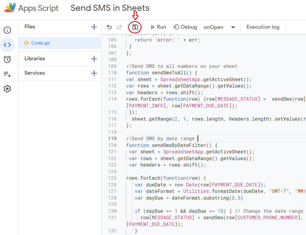

Before you exit the Apps Script editor, make sure you save all the changes you’ve made. Click on the floppy disk icon to save your project.

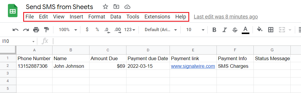

After you’ve saved your code, you’ll need to reload your Google Sheet. Close and re-open the page or click refresh and you should now see your new menu options at the top of the page. It may take a few seconds for those menu options to appear each time the Google Sheet is opened so if you don’t see them immediately, just wait a few seconds.
Go through your credentials’ steps and enter your Project ID, Auth Token, Space URL and the SignalWire number you’d like to send the SMS from. To find these credentials, log into your SignalWire space and select API from your dashboard. If you haven’t done so already, you’ll need to create an API token and for this example you’ll need to make sure that ‘Messaging’ is enabled for the token.

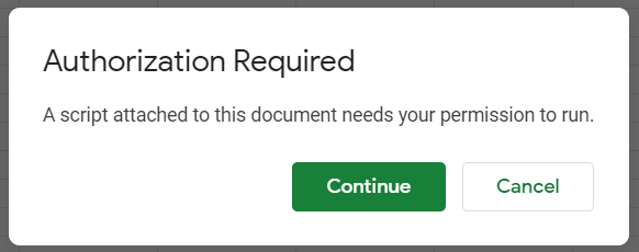

When you attempt to enter your first credential, you’ll be prompted by Google Sheets to authorize the script you entered. Follow the steps Google Sheets provides to give permission for running the script.
