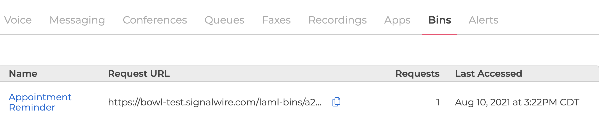

When you save your bin, you will see a paper stack icon next to the URL. Click this to easily copy your URL and paste it into your cURL command!
