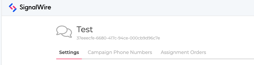

  • Lastly, you will need the Campaign SID in order to assign the number to the campaign. You can find your campaign SID by going to the Messaging Campaigns section of your SignalWire space and clicking the specific campaign whose numbers you need. The SID is the long alphanumeric string at the top as shown here:
