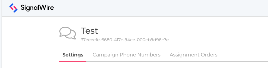

You can find your campaign ID by going to the Messaging Campaigns section of your SignalWire space and clicking the specific campaign whose numbers you need. The ID is the long alphanumeric string at the top as shown here:
