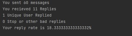

An example of output would be printed to the console like so:
You sent 60 messages
You recieved 11 Replies
1 Unique User Replied
0 Stop or other bad replies
Your reply rate is 18.333333333333332%
