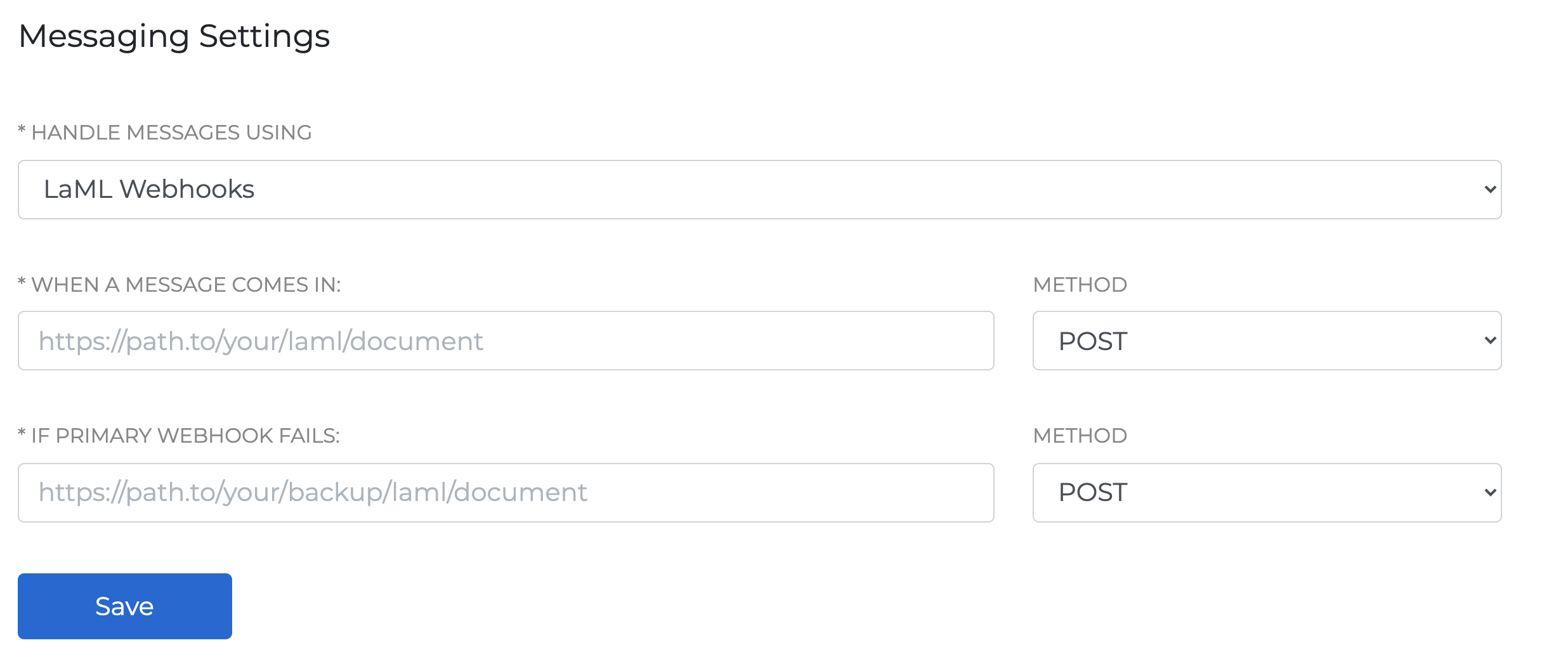

Click the Phone Numbers tab on your lefthand side nav within your SignalWire space, and click the specific number that you would like to set up call forwarding on. If you don't have a number yet, now is the time to buy one!
Make sure that Handle Messages Using is set to LaML Webhooks, and paste your Bin URL in as the value for When a Message Comes In. Save, and you're done! Your messages to this SignalWire number will now be forwarded to the number that you designated in the bin.
