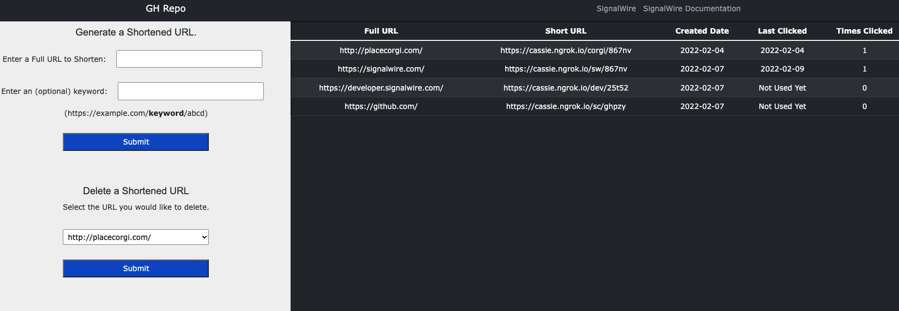

This application requires very little setup in order to handle all of your shortened URL needs for messaging. It can easily but customized in several spots which we will walk through step by step below. There are two functions - one to generate shortened URLs and one to delete shortened URLs. We will also have two Flask routes - one that redirects shortened URLs to the full URL and one that handles the shortened URL interface. The finished product will look like this:
