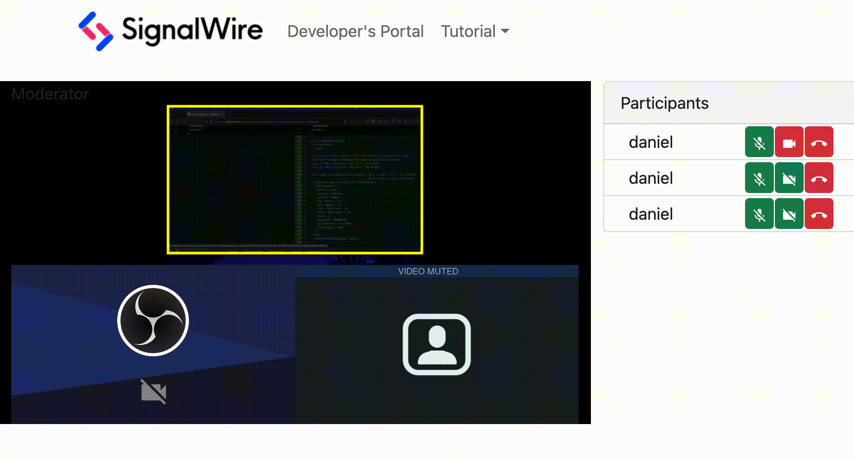

We want our overlay to show as a yellow rectangle. Let us add a function, updateSpeakerOverlay, right before the layout. This function will take as parameters the id of a member, and whether it must show as currently speaking. It then finds the position of the overlay and updates its style.

The talking participant will now get highlighted.
