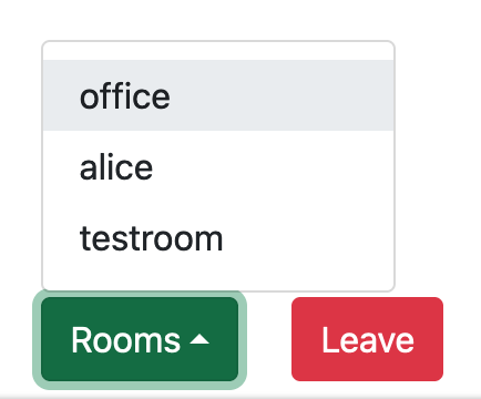

We can add a way for our video-conferencing users to dynamically switch to one of the other currently active room sessions. We are going to add to the room UI a button that shows a list of active room sessions and allows to switch to one of those:

After all our functions are defined, we can add our button to the UI:
<DropdownButton
  title="Rooms"
  variant="success"
  drop="up"
  onClick={() => refreshRoomList()}
  {rooms.filter(r => r !== roomDetails.room).map(roomName => (
    <Dropdown.Item
      key={roomName}
      onClick={() => roomSelected(roomName)}
    >{roomName}</Dropdown.Item>
</DropdownButton>
