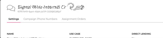

You will also need your campaign SID which can be found in your portal under Messaging Campaigns -> Campaigns or by listing campaigns using our endpoint.
