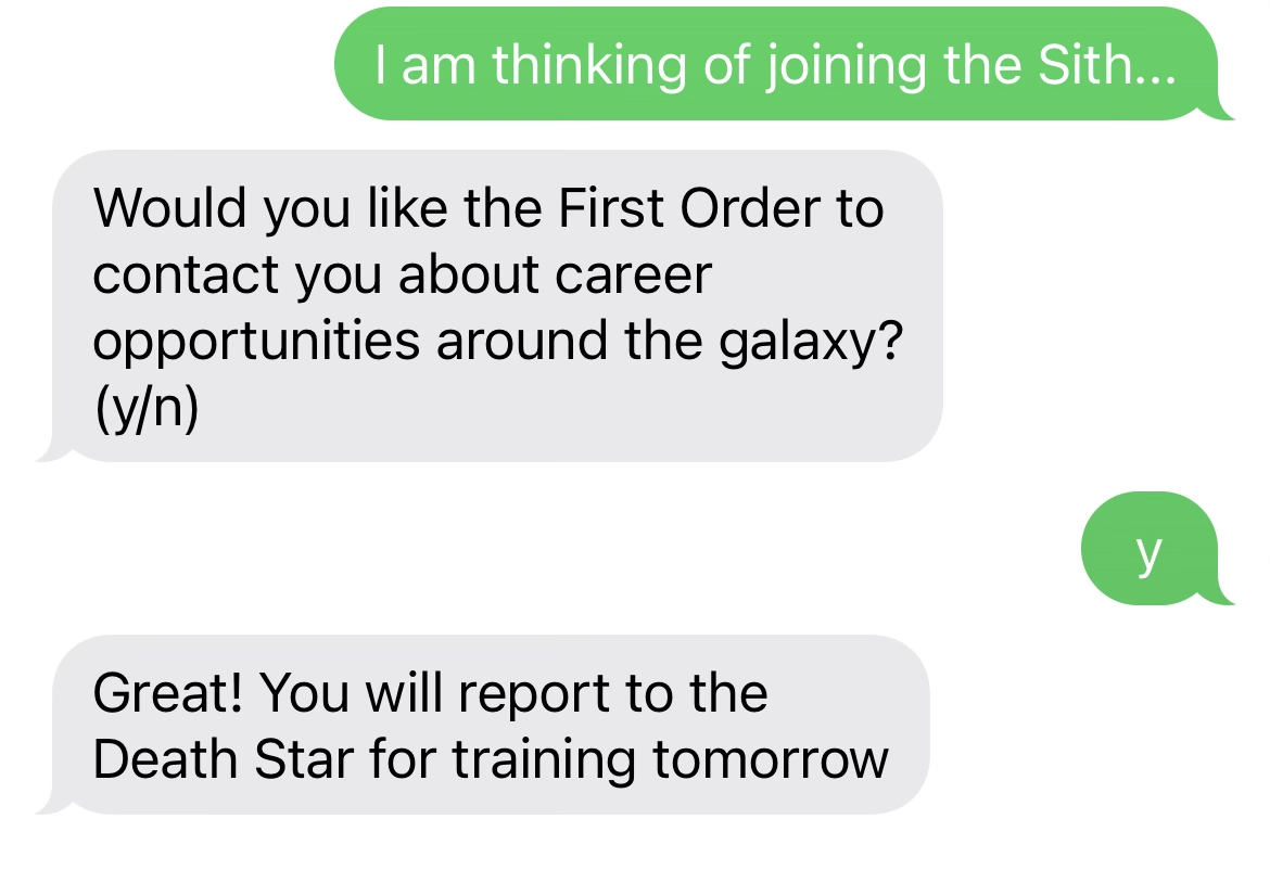

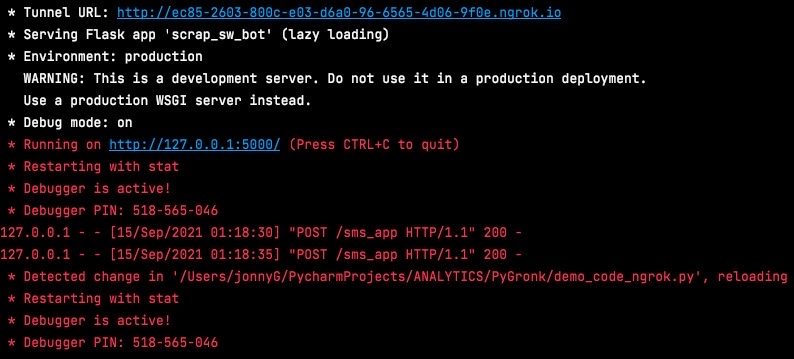

After your program has run properly, your console should look something similar to this below. All of that Red is actually good in this case because we can see that we are connected and running our webhook. There was some activity to our project and we can see that there were two incoming messages to our application. Both with status 200 so all should be working well.
Now, it's time to test our application by texting into it!
