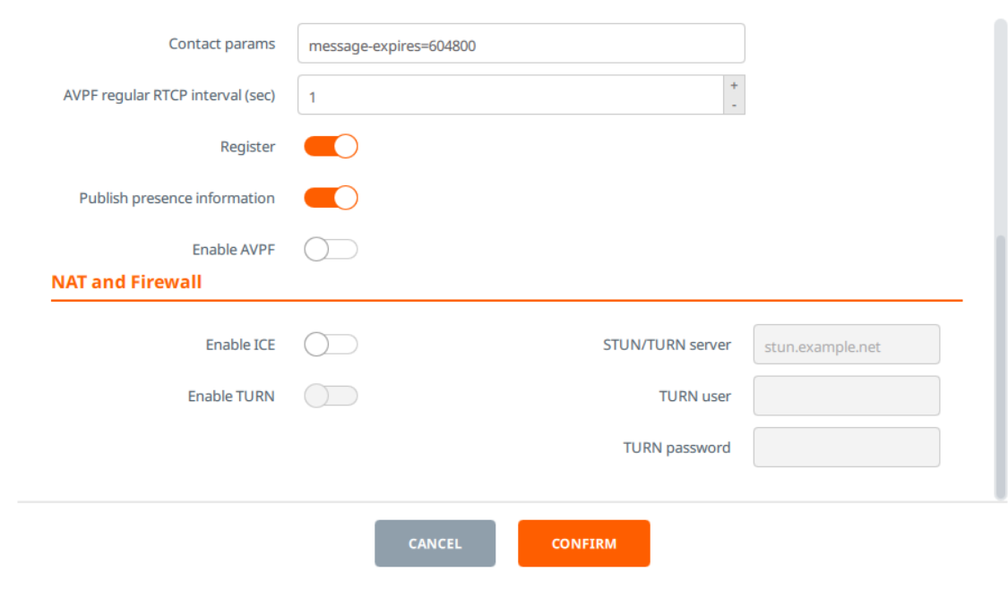

Next, we will need to go through the following settings pages in order to specify the correct information. Make sure to disable Enable AVPF and Enable ICE or it will not work correctly.

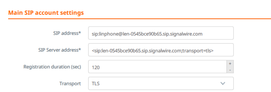

SIP Address and SIP Server Address are created using the SIP domain generated after creating a SIP endpoint in the first step
- SIP address: sip:[email protected]
- SIP Server address: <sip:user-0545bce90b65.sip.signalwire.com;transport=tls>

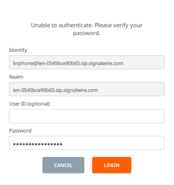

If you get the error Unable to Authenticate. Please verify your password., enter your SIP endpoint password and click Login.
