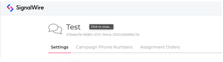

This script does not require any additional packages except for those native to Python! However, you will need the campaignSID of the campaign that will contain the numbers you are assigning. You can find your campaign SID by going to the Messaging Campaigns section of your SignalWire space and clicking the specific campaign whose numbers you need. The SID is the long alphanumeric string at the top as shown here:
